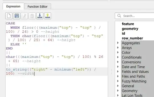

  • Thank you! This worked for me in Qgis 3.32. In this case, I made my grid cells to be 100m x 100x The CRS was in meters the values of "top" below were the same units. My maximum grid label was BQ79 and the values were correct based on my random review. enter image description here enter image description here enter image description here
CASE
      WHEN floor(((maximum("top") - "top" ) / 100) / 26) > 0 --height
      THEN char(floor(((maximum("top") - "top" ) / 100) / 25) + 64) --height
      ELSE ''
    END
    char(((maximum("top") - "top") / 100) % 26 + 65) --height
    to_string(("right" - minimum("left")) / 100) --width
