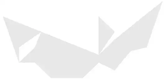

Here is a raster-based solution. It's fast (I did all the work from start to finish in 14 minutes), requires no scripting, takes only a few operations, and is reasonably accurate.
Start with a raster representation of the polygon. This one uses a grid of 550 rows and 1200 columns:
In this representation, the gray (inside) cells have the value 1 and all other cells are NoData.
Compute the flow accumulation in the west-to-east direction using the unit cell values for the weight grid (amount of "rainfall"):
Low accumulation is dark, increasing to highest accumulations in the bright yellow.
A zonal maximum (using the polygon for the grid and the flow accumulation for the values) identifies the cell(s) where the flow is greatest. To show these, I had to zoom in toward the bottom right:
The red cells mark the ends of the highest accumulations of flow: they are the rightmost endpoints of maximal-length interior segments of the polygon.
To find these segments, place all the weight at the red cells and run the flow backwards!
The red stripe near the bottom marks two rows of cells: within them lies the maximum-length horizontal segment. Use this representation as-is for further analysis or convert it to a polyline (or polygon) shape.
There is some discretization error made with a raster representation. It can be reduced by increasing the resolution, at some cost in computation time.
One really nice aspect of this approach is that typically we find extreme values of things as part of a larger workflow in which some objective needs to be attained: siting a pipeline or football field, creating ecological buffers, and so on. The process involves trade-offs. Thus, the very longest horizontal line might not be part of an optimal solution. We might care instead to know where almost longest lines would lie. This is simple: rather than selecting the zonal maximum flow, select all cells close to a zonal maximum. In this example, the zonal max equals 744 (the number of columns spanned by the longest interior segment). Instead, let's select all cells within 5% of that maximum:
Running the flow from east to west produces this collection of horizontal segments:
This is a map of locations where uninterrupted east-west extent is 95% or greater than the maximal east-west extent anywhere within the polygon.

Hopefully your lake polygon has a number of points, you can create lines on these points with a azimuth (aspect, geo direction). Choose the length of the lines big enough (ST_MakePoint part), so that you can calculate the shortest line between the two most distant lines.
Here is an example:
The example shows the maximum width of the polygon. I choose ST_ShortestLine (red line) for this approach. ST_MakeLine would increase the value (blue line) and the the endpoint of the line (bottom left) would hit the blue line of the polygon. You have to calculate the distance with the centroids of the created (help)lines.
