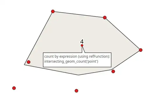

I have a polygon and a point layer. The polygons contains buildings, the points should be the edges of the buildings. A building is "good" as much as points are touching or in the near (buffer 0.2 meter) of the building. There are no other references between the layers.
I need the number of touching or intersecting points and points within a near of 20cm. With that result I'm able to say, which building have got the best quality...

    So what's going on in the above example? You've got three red points that are right on the corners of the polygon, two that are close (one in and one out), two that are right outside and one that is right inside. Or is that inside point a label you've generated according to that expression? What answer do you expect given the diagram you've shown? – Spacedman May 13 '19 at 08:49

    If I get you right you want to count the points that are less than 20cm away from the polygon boundary (for a statement on one of your layers "quality" you should take points inside and outside into account), so shouldn't you buffer 20 cm outside, 20 cm inside and count the points withing the difference of both? Or would it be a better approch to test points within a 20 cm distance around the polygons vertices? – Jochen Schwarze May 15 '19 at 07:11
  • Yes, of course, it would be better to count the points next to the polygon vertices. If a (buffered) point fits completely inside a polygon, it would not be counted by intersect (because it's within). – MartinMap May 15 '19 at 07:24
