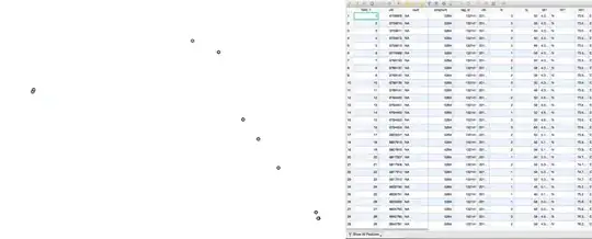

Points and attribute table for <code>node_point</code>layer Points and attribute table for the node_point layer

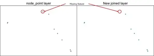

New joined layer The node_point layer (left) and the new joined layer (right, using the Join attributes by location tool) with missing feature highlighted

I've tried checking the validity of the node_point layer and all the features node_point layer are all right, so I'm not sure what I'm doing. Reversing the Target and Join vector layer parameters don't change the (undesired) result either. Any thoughts? The expected result is that I have a new layer that has all and only the points from the node_point layer with the attribute tables combined by location.

  1. Added screenshot of interpolated_point and node_point layers and their attribute tables (as suggested by @pdavis)

Thanks for posting edits to help clarify. There are two things wrong here:
  1. You are not correctly understanding the 'within' predicate. This means that one geometry is fully contained within another geometry so using it with points doesn't make sense. The second answer in this post offers a succint explanation on geometric predicates. My guess as to why you are getting any returns at all is because you have so many points along the line, that one will fall 'within' your node points based on some default precision threshold used by the tool. But I don't know for sure . . .
  2. Apparently, the precision parameter in QGIS 2.x didn't work and has been removed for 3.x. See this post: Join Attributes by Location - Precision
Your operation is a fairly standard analysis and the best way that I've found to accomplish what you want (in QGIS) is to use the NNJoin plugin. Why QGIS doesn't have native tool to do this I can't understand. Maybe other readers of this post can elaborate.
