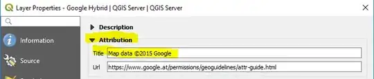

Layers obtained through the QuickMapServices plugin come with Attribution metadata, but it doesn't look like OpenLayers basemaps have any Attribution metadata. Here's what the Attribution metadata looks like for the "Google Hybrid" layer obtained through the QuickMapServices plugin:
So a quick and easy way to attribute this basemap is with this attribution text: "Basemap: Google Hybrid, Map data ©2015 Google"
or "Basemap: Google Hybrid (obtained through QuickMapServices QGIS plugin), Map data ©2015 Google"

Each basemap provider (Google, OSM/Stamen, Bing, Apple Maps, Wikimedia Maps, etc) has their own terms of service. The best/safest method is to read the current terms of service for the data provider of the basemap you're using. Notice in the image above that underneath the map Title, is a web address for Google's attribution guide. If you go to this page, you'll find rules about what Google does and doesn't allow you to do with their basemaps.
Most basemaps from the QuickMapServices plugin have this link included in their metadata. OpenLayers doesn't provide this link, so you'll have to locate it yourself on the website for the data provider.
