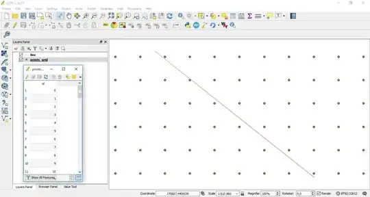

You can also use QGIS expressions for this. See below for the expression to get a 0 or 1 output for each point, depending on which side of the line it is (see below for curved lines). The solution is based on function azimuth() to calculate the north-based angle of the line connecting the closest point on the line to the current point:
with_variable(
'line', -- name of your line layer
overlay_nearest ('line',$geometry)[0],
azimuth (start_point(@line), end_point(@line)) >
azimuth(
closest_point (@line,$geometry),
$geometry
Point layer labeled with the expression above:
