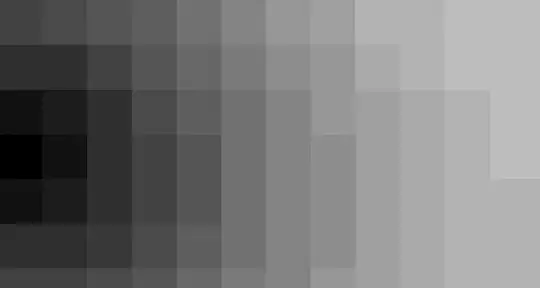

I want to change the resolution of a raster and smooth the gray ramp like shown in the images bellow. The preference is to use GDAL, PIL or Numpy.
Description:
I'm kriging points into rasters with an output resolution of 20 meters with the High Performance Geostatistical Library. I don't want to change the output resolution because the interpolation time increase exponentially.
With this resolution the output image is ugly (pixelated and aliased). I don't know if it is conceptually correct but I want the image to be smoother like in the example bellow. It's something like 'reinterpolating' the image into a better resolution one. I'm using python so my preferences are GDAL, Python Imaging Library or Numpy. The answer could be theoretical, like pointing out the algorithm name or the concept of this kind of operation.

EDIT Results with gdalwarp cubic spline:

  • frankly that doesnt look at all like cubicspline or any other sampling that would do interpolation of neighboring pixels. if it were you would get a mixture of colors at the boundaries between different colors. to me this looks like the image was upscaled and then a median filter was applied, because this would preserve clear boundaries between the colors. – Kevin Kreiser Aug 25 '21 at 03:19
1) The hard way: With a bit of coding it's (relatively) easy to implement bilinear interpolation to accomplish decent resampling.
2) The easy way: use GDAL as explained in this previous GISSE post, but in reverse (decreasing the pixel size).

    It worked. The best results were with cubic spline. I've posted the results above. Thanks. – Pablo Aug 01 '12 at 12:04
Use GDALReprojectImage, which is exposed in Python:
from osgeo import gdal
help(gdal.ReprojectImage)
For the smooth interpolation, use bilinear or cubic methods. This function is awkward, since it doesn't take keyword arguments, thus you need to find the position:
gdal.ReprojectImage(src_ds, dst_ds, None, None, gdal.GRA_Bilinear)
Probably the tricky part is setting up dst_ds, which needs to have a geotransform similar to src_ds, but with modified cell sizes.

    I don't think the OP wants to smooth out the variations: otherwise, why go to the effort of kriging in the first place? All its benefits would be lost. Instead, as the images suggest, the question asks for a smooth resampling procedure to create a higher-resolution version of the results already obtained (which is a smart and efficient way to speed up kriging). – whuber Jul 31 '12 at 16:39

you can use a rank/median filter with radius=5, i.e kernel size size=11, (for each rgb channels).
