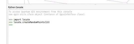

Then open the Python console and run the following code:
import locate.py
locate.createRandomPoints(10)
Python Console

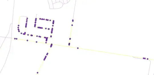

The result should look something like this
Results
