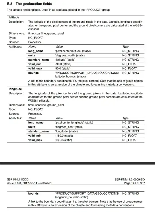

<edit 3: There's S-P instruction manual at http://www.tropomi.eu/sites/default/files/files/S5P-KNMI-L2-0009-SD-S5P_level_2_Input_Output_Data_Definition-9.0.0-20170614.pdf, from there the following explanation. Then judging from https://www.gdal.org/gdal_translate.html maybe -a_srs EPSG:4326 -a_ullr 2.1418159 128.72141 25.532017 99.929924 could be added (or in some other order) to the original command line.
S-5P coordinate referencing explanation
