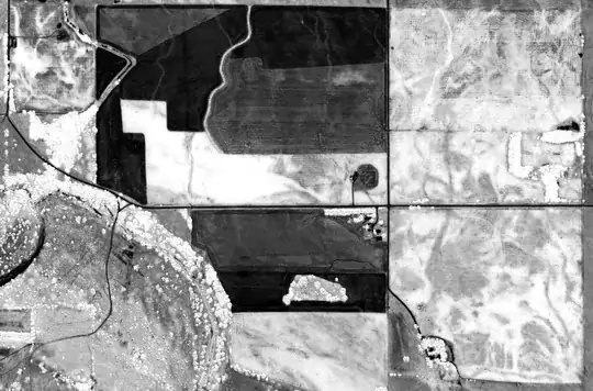

I have been using NDVIs with limited success to identify trees in the central Great Plains region of the USA. The problem I have been encountering is that reflectance from farm fields/pastures have essentially the same spectral signature as the trees I am identifying. Is there a vegetation index which can be generated from 4-band NAIP imagery that can do a better job at isolating tree cover mixed throughout agricultural areas? Perhaps a pre/post processing step may be most effective?
NDVI Example
