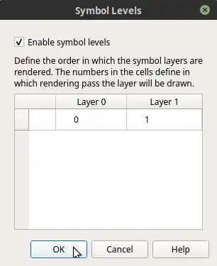

    • click on the Line symbol layer group in the top panel and open Advanced | Symbol levels...; in the follow up window, assign the drawing order of your Symbol levels (Note: Layer 0 refers to the first Symbol layer that was present, which is, per default, the downmost Simple line layer in the panel); a lower number will be drawn in an earlier drawing pass:
    • ...and apply an opacity level of, say, 30% to the whole Symbol layer group:
  • enjoy, possibly having a beer
Why does this do what it does?
The Symbol levels will define the rendering order of each Symbol layer. In this setup, the darker blue line is drawn first, for the whole set of features instead of for each feature individually; in the next draw pass, the lighter blue line is drawn, effectively on top of the first, again for the whole feature set. The road lines will have the visual effect of being joined smoothly.
