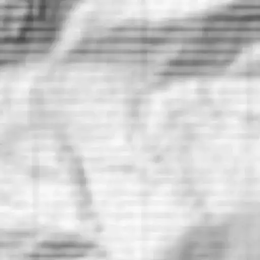

While it indeed solves the integer overflow error, here's the result:
When using normal process (compressed gdalwarp + gdaldem hillshade), I get this (but I get the integer overflow error when running on my huge tif, here I ran it on a smaller file):
Is there a way to get the gdalwarp + gdal_translate + gdaldem solution to produce a result without the weird pattern?

  • So, the solution I found indeed avoids the integer overflow, but the image produced has a weird pattern. I edited my question. – Tim Autin Aug 14 '18 at 09:07
  • Interesting, translate into vrt should not affect the data at all. Is the result the same if you run gdaldem from test.vrt? – user30184 Aug 14 '18 at 09:25
  • Yes, same result :/ – Tim Autin Aug 14 '18 at 09:34
  • Might be worth noting that generating to 90m resolution seems to work (but the patterns may simply be too small to be seen at that resolution). – Tim Autin Aug 14 '18 at 09:37
    What is the native resolution? If you oversample then the default nearest neighbor resampling may lead to artifacts. I would have a try with "average". – user30184 Aug 14 '18 at 09:43

  • Resolution of the raw.tif is 1296001 * 417601. It's the 30m resolution SRTM file, so I'm not oversampling. Result with -r average is a little bit better but the pattern is still there. – Tim Autin Aug 14 '18 at 10:06
  • But using the bilinear resampling is working, thanks a lot man! – Tim Autin Aug 14 '18 at 10:22
