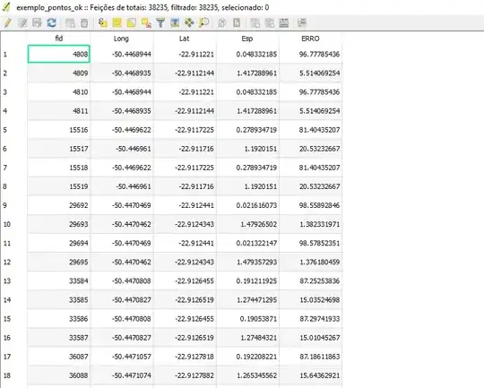

I have a sample file where it was done but I do not know how it was calculated nor how the points were generated: enter image description here
The atribute table os points shp: enter image description here
