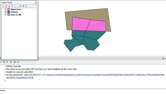

The screeshot of processing script UI when I try to run it is below:
UI of processing script
Both of the algorithms work correctly standalone, but when I try to pipe them it does not work as intended. I only get clipped_layer as output and the following error notification in Python Console:
There are several questions adressing related issues like Pipe custom processing algorithm output into another in QGIS 3.0 but none really answers my question.
Does anybody know how to correctly pipe algorithms in the example processing script provided above?
I know it could be solved by using Processing Modeler but since I plan to expand the script further, please, don´t suggest this as solution.

    Try using fin_area = processing.runalg("qgis:dissolve", clip_area['OUTPUT'], "true", None, processed_layer) – Joseph Apr 20 '18 at 15:12
The processing.runalg() return a python dictionary with one record: 'OUTPUT' is the key and the value is the absolute path at result layer.
So in the next algorithm instead of the parameter clip_area you have to use clip_area['OUTPUT']
Oscar Campo
  • 556
  • Yes, you need to specify the 'OUTPUT' with the output layer. This worked for me. Thanks
    Does this work for all kind of algorithms with spatial outputs?
    – Yanic Apr 23 '18 at 07:48
    Sometimes changes the key string value 'OUTPUT', you have to print the dictionary result to know it... Take care that all of this is heavily changed in QGIS 3.0 – Oscar Campo Apr 23 '18 at 08:26
