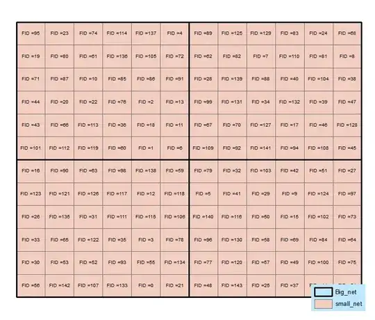

Input shows small cells labelled by their physical order:
enter image description here Solution below mostly uses standard tools:
