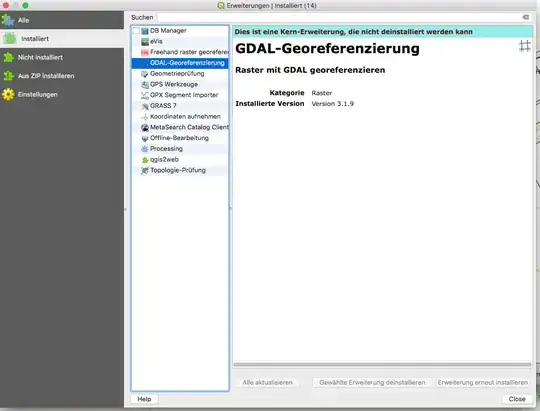

I just upgraded to QGIS 3.0 (OS X as well on Windows 10) and can not find out how to do some georeferencing. I am told by the software, that GDAL georeferencing is still installed and that I could not remove it, and that it should be in the category "raster". But I can not find it there, also not in other parts of the menu.
screenshot GDAL georeferencing plugin
new profile created, but the same issue...:

  • Is "GDAL Georeferencing" "active" in the plugin list? Tick the box next to the name in the plugin list. – Spacedman Mar 12 '18 at 21:02
  • Thanks a lot, but there is no clickable box next to "GDAL Georeferencing"... – Theresa Pommern Mar 12 '18 at 22:03
    That looks broken - there should be a tickbox next to it like you have with "DB Manager". Try creating a new profile from the settings menu - this gives you a clean QGIS setup (you won't lose your current one) - and see if you get the same behaviour. – Spacedman Mar 13 '18 at 08:03
  • thanks a lot. So I have created a new profile, but...again there is no clickable box... – Theresa Pommern Mar 13 '18 at 08:29
    Its not just the georeferencer - it seems all your core plugins except eVis have the same missing checkbox. Check the logs (View.. Panels.. Log Messages) I think you may need to report this as a QGIS issue. – Spacedman Mar 13 '18 at 10:32

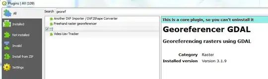

Place the box next to Georeferencer plugin and activate it:

You should be able to tick the box next to Georeferencer GDAL.
After which it will be in the Raster menu.

I had the same problem. But, then I clicked on "Installed," searched for "georeferencer" and the check box appeared for me to choose it to activate. It appears under Raster now.
