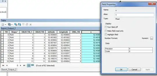

The result of calculating geometry (X,Y coordinates) can be different depends on the type of the fields and the scale.
Let's assume that I have a table of XY coordinates of some points and convert it to shapefile (WGS84)
As we can see from the table above that our X,Y coordinates has 6 decimal places.
Now I will add a field with name x as float and I calculate X-coordinate using calculate geometry. I will get the result rounds to 4 digits.
Then I will add a new field with name x_exact and I will use for that Double with 6 scale value. then I will calculate the geometry x-coordinate and the result is the exact coordinate with the same number of digits as my original values.
Here, are the differences between the field's type in ArcGIS
If we plot both results (x,y and x_excat,y_exact) we can notice the difference when the map scale is 1:1000)
Moh
  • 1,588
    Thanks for the info. Unfortunately, it does not answer our question about the SQL view query layer. Creating the calculated geometry fields was just an investigative measure. Also, it seems I can’t add a pic to show it, but I created a shapefile with type of Double, 9 precision 5 scale and got the same results. To make extra sure that I wasn't messing up the field creation, I made another set of fields with the same parameters and just used the Field Calculator to pull in the values from the original fields, and they do look as they should. – user104307 Mar 12 '18 at 14:01
