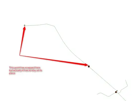

enter image description here But like you see there are points witch snapped to the wrong place or has snapped to more than one.
For exemple This point has snapped to the wrong place where the other point has already snapped to enter image description here

  • How do the geometries look like? What are their coordinates? What's the CRS you're using for storing the data and for displaying the results? – IvanSanchez Jan 24 '18 at 15:30
  • What do you mean "snapped to the wrong place"? Can you give us an example of an expected behaviour, an what is actually happening instead? – Roberto Ribeiro Jan 24 '18 at 15:49
  • so you want each greenish point (f.Geom, I guess?) to snap to the nearest red point (g.Geom ?) only if that one is not already occupied? – geozelot Jan 24 '18 at 16:04
  • Yes and no i want to each point to snap to the nearest point even if ther is two points that are near each other they can snap to the same red one but in this case i have the green point wich snapped to the red wich is far – Rania ben othmen Jan 24 '18 at 16:08
    in this case, is there another red point closer? if not, your query works just fine. the st_distance you use as tolerance does alway find a point to snap to, but having a multipoint as reference geometry does make that harder to control. – geozelot Jan 24 '18 at 17:12
