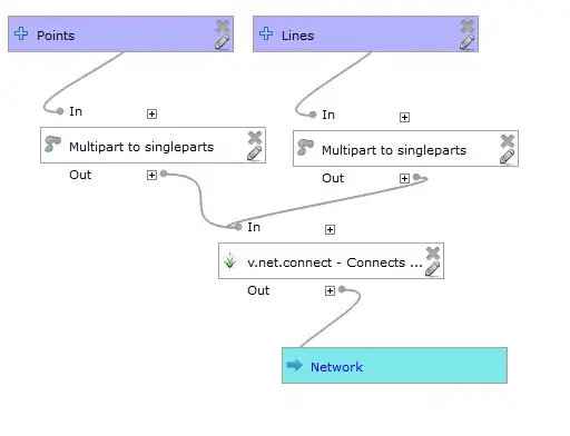

I was having similar errors with v.net.connect not producing an output in QGIS 2.18 too, and what typically works for me is running Multipart to singlepart on both inputs (line and point layers), prior to running v.net.connect.
In the graphical modeler, it will look something like this:
You might also have to run v.net.clean on the multipart to singlepart output, but generally that should work.
