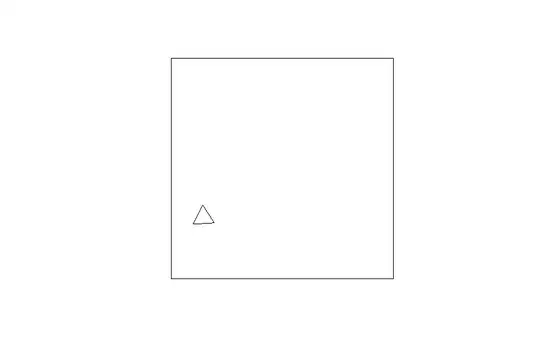

And this is when I get the error about the extents that do not overlap. To be sure, I tried to simplify the GEOTiff to just its extent and then plotting that over the specific polygon I have selected:
  raam <- projectExtent(Aerialfiletocheck,"+proj=longlat +ellps=WGS84 +towgs84=0,0,0,0,0,0,0 +no_defs")
  raam.shape <- as(raam@extent, 'SpatialPolygons')
  plot(raam.shape)
  plot(tempshape,add=T)
Yielding this plot, where the large rectangle is the extent of the GEOTiff and the funny triangle being the polygon I selected. enter image description here

You need to use projectRaster(Aerialfiletocheck,tempshape) to change raster's projection... BUT! do not change raster projection, change vector.
If you pretend to project raster, you have two methods to resample information (nearest neighbor and bilinear interpolation). As a resample, new information will be created, so you'll change the original data of your raster.
Instead of this, use spTransform(tempshape, Aerialfiletocheck@crs) to project vector. With the new vector object you can crop, mask, and so on.

  • Can you explain why my initial plot showed that their extents do overlap even though they were in different coordinate systems? – Waldo vdM Dec 13 '17 at 10:05
  • @WaldovdM as function documentation says: projectExtent returns a RasterLayer with a projected extent, but without any values. The CRS used is the same one that shape layer, so the plot shows overlapping features. – aldo_tapia Dec 13 '17 at 10:23
