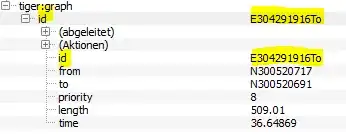

As you can see, the attribute edgeid is still empty and I want to fill it with the id of the nearest street. Each line in the street-line-layer has an edgeid as followed: enter image description here
