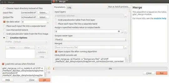

I want to merge raster layers I have created in different software (SNAP). I know about merge tools in QGIS (qgis merge and gdal merge). I have problem with null values in the rasters which were created.
When I use merge tool which is in the QGIS menu I can set to ignore null values and result is correct.
When I use gdal merge tool (processing tool), null values are not ignored and result is not correct because there are stripes with null values in the result raster. There is no parameter to ignore null values (null data parameter does not ignore null values it just set selected value as null value)
These are my parameters in tools.
And my problem is there is no qgis merge tool in the pyqgis. Only GDAL merge tool. I checked by processing.alglist() in QGIS. I think I can use vector merge which is implemented (qgis:mergevectorlayers -> polygonize every raster, select and save only features with value 1 and merge) but I would like to "get rid of" lot of rasters (vectors) sooner and use raster merge and not to poligonize lots of rasters. Yes, the final step is polygonization but I want to polygonized merged raster.

  • Try to build vrt with gdal in the processing tools. It has some parameters that's for no data. – SIGIS Nov 07 '17 at 06:42
  • Thanks. I can than work with virtual layer in pyqgis and save it ? – zubro Nov 07 '17 at 07:17
  • Yep definitely! – SIGIS Nov 07 '17 at 07:25
  • @SIGIS I have tried to build virtual layer but there is also a problem, If I choose option stacklayer it creates mosaic correctly but it creates a band for each raster. When I polygonize the virtual raster, only first band is polygonized. If I do not choose stacklayer, it creates one band but same wrong output as GDAL. – zubro Nov 07 '17 at 08:20
  • Ok can you post the command that the menu tool (raster/merge) prompt you ? – SIGIS Nov 07 '17 at 09:17
  • QGIS/Raster/Merge: gdal_merge.py -n 0 -a_nodata 0 -of GTiff -o ./mozaik.tif ./terrain_corrected01.tif ./terrain_corrected02.tif – zubro Nov 07 '17 at 09:48

  • I have tried now gdal_merge.py -n 0 -a_nodata 0 -of GTiff -o /home/lukas/zdffgl /home/lukas/terrain_corrected05.tif /home/lukas/terrain_corrected06.tif and it was done correctly ! But I copied command to the script and there is error AttributeError: 'NoneType' object has no attribute 'messageBar'. But gdal alone works. – zubro Nov 07 '17 at 16:15
  • This error is normal because you don't have the iface instanciated as you run a standalone script. But it did not tell me why the exitCode is not 0 (everything is OK) but in shell it's OK. – SIGIS Nov 07 '17 at 20:54
  • Thank you for help and time. I have used gdal_merge without pyqgis after all, I did not know I it possible to use it without pyqgis. Could you just tell me how it works ? How it recognized gdal_merge.py in bash script just by name if the path to the gdal script is not declared anywhere and it is part of QGIS ? Also is it better to run gdal_merge in python scripts or it is ok to run it just as simple command in bash script. Thanks for all help it was really helpful. I have just thought I need to install GDAL standalone (not as part of QGIS) to use it without qgis as library in shell. – zubro Nov 08 '17 at 12:52
  • You are welcome, always a pleasure to help. I wanted to tell you to use gdal_merge without pyqgis, but it is not the question. I edit my answer about your questions. Which PPA have used ? (ubuntugis or qgis.org) – SIGIS Nov 09 '17 at 09:00
  • I have qgis.org. I will use it without QGIS. I use QGIS for another steps but I run whole process in docker and I have for every step in processing own container so I can choose for merging gdal without python. Many thanks. – zubro Nov 09 '17 at 09:23
