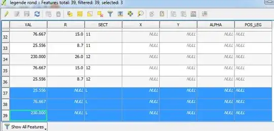

You can remove those 'lines' by identifying them from the Attribute Table in the SECT field where the value is an L:
Attribute Table
As a quick example, I created a new ID field from the Field Calculator using the expression $id to create unique values. I used this to create a categorised style and label the polygons:
Result

  • @Joseph did the $id labeling method give the result u're showing ? Does that mean the plugin generate the objects in a given order ? What if we want to label the generated polygons using another logic ? – Snaileater Sep 19 '17 at 09:34
  • Oh ... sector and radius are in the attribute table ... it's ok ! – Snaileater Sep 19 '17 at 12:04
    U will notice that generated polygons of a same "slice" are overlaid. In Joseph's example Polygon 3 is overlaid with 2 which is overlaid with 1. Maybe that does'nt comply with Andrew's computation needs ... – Snaileater Sep 19 '17 at 12:06
  • @snaileater - It's a little strange. If you output the legend as a memory layer then use the Save As... option to save it as a shapefile, the polygons seem to be 'clipped' automatically (i.e. no polygons are overlapping). But if you output the legend as a shapefile, the overlays are there. – Joseph Sep 20 '17 at 09:49
