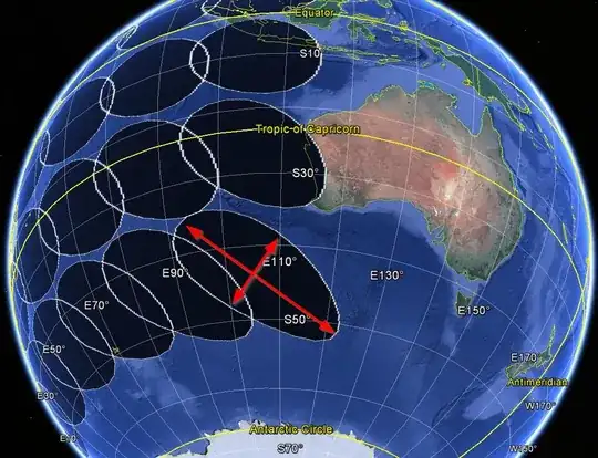

The image below depicts the distorted Euclidian buffers (1000 km radius) produced with the code from above. Euclidian buffers
