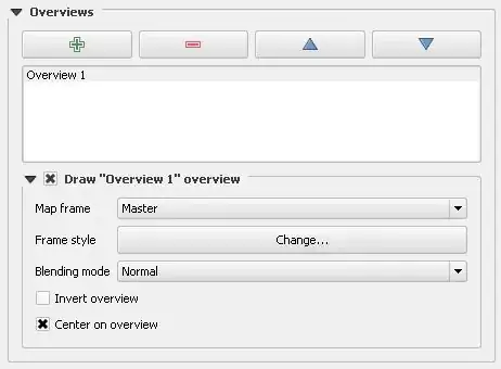

Another elegant "no code" solution for the synchronization of composer maps uses the built-in "Overview" mechanism of QGIS:
Therefor we add a "Master Map Frame" overview to every map window, that should be synchronized with the master map. Then we set frame style to No Brush/ No Pen and enable "Center on overview".
To fix the scale of the child map, we enter an Expression value: enter image description here
That's all.
Very easy and very dynamic!
