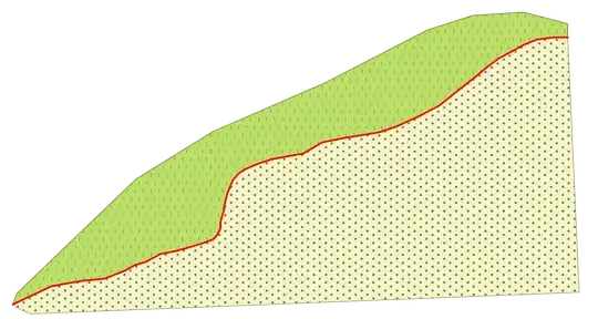

Finally, let's assume to start from this situation, where the red line is the guideline and the two polygons are two separate layers (each one having one feature):

and you will get this result:
If everything works, the edited polygons will perfectly match the guideline and have both the edges and the vertices perfectly aligned to it.
