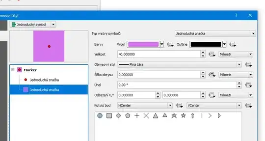

You can try create style layer, which will be same as buffer.
Legend
In style properties:
Style marker
