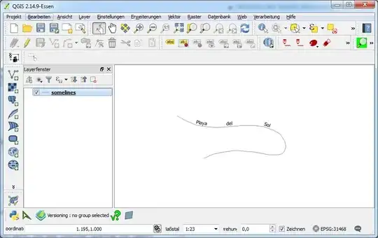

Some possible approaches:
a) If you really want to label your points automatically, the task would be to derive the orientation of the nearest line segment to each point, store this in an attribute and make use of 'data defined override' for the rotation of point labels (if you still don't have it, see above).
b) If you do not have too much data, you may consider placing the labels manually, refer to https://www.youtube.com/watch?v=JNQCaT9GH7A or Move label in QGIS? for example or g**** for 'qgis move labels'
c) My favourite solution would be an additional attribute to your linestings containing the road name, with very many blanks in between the words, then use placement option 'curved' to place the label as you desire. The result will look sth. like
