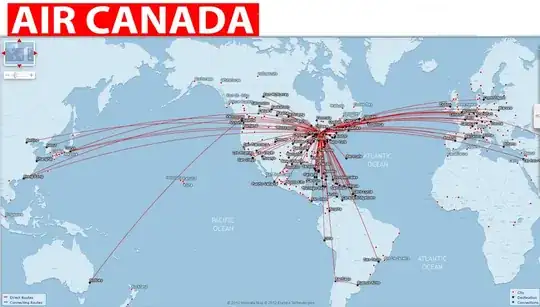

Depending on where your distance info is coming from, this may not matter. If you have a simple number giving the distance, the distance will be the same on any map projection which shows distance accurately (not Mercator, think pretty much any "equidistant" projection, such as an azimuthal orthographic projection or similar. A conformal projection, like Lambert Conformal Conic will do a reasonably okay job at the distance.). If you calculate and create the buffers in an equidistant projection, they will be (fairly) accurate, see here on how distance is calculated: ArcGIS Help
Be sure to set the layer's coordinate system is in an equidistant projection, not just the data frame.
Once calculated, the buffer will warp accordingly when put into Web Mercator or whatever other web projection you intend on using.
As far as why the lines themselves are curved, and why this might create problems:
The key problem is that plane routes on a Mercator projection such as this one are displayed as curved, like so:
Air Canada route map
This is a fundamental problem with Mercator maps, as they are intended for nautical navigation, where the properties of straight lines on these projections is valuable (a straight line on a Mercator projection is a rhumb line; a line with the same compass heading through the entire journey).
However, planes do not fly on rhumb lines, because fuel efficiency is more important than simple navigation, and thus fly along Great Circles, which appear as curves on a Mercator projection.
