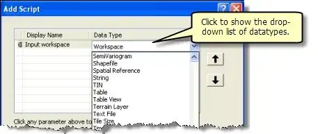

When adding a python script to a toolbox in Arcgis one of the steps is to set parameters and specify what Data Type each requires. The list is long, perhaps a hundred, and many are not immediately understandable. For example I just tried to require data type "Database Connections", but when I run the tool and select "Database Connections\Connection to foobar.sde" I'm told the item is invalid. Aww nuts.

See 'Geoprocessing_data_types.pdf' in Data types for geoprocessing tool parameters
To answer your specific question, I belive you would want to use a Workspace parameter which will let you specify an SDE connection file, then use filters to limit the workspace type (see screenshots in comment below).

  • thanks! Dunno how I missed that, since I did see that page in my searches; had my no-pdf's blinkers on I suppose. And for nitpicking clarity: the answer to my problem is use Workspace parameter (but that doesn't restrict to sde workspaces, which was the initial goal), and the answer to the specific question is "The Database Connections worktype is The database connection folder in ArcCatalog." – matt wilkie Apr 19 '12 at 16:23
    You can specify a filter for Workspaces: Step 1, Step 2 – blah238 Apr 19 '12 at 17:07
