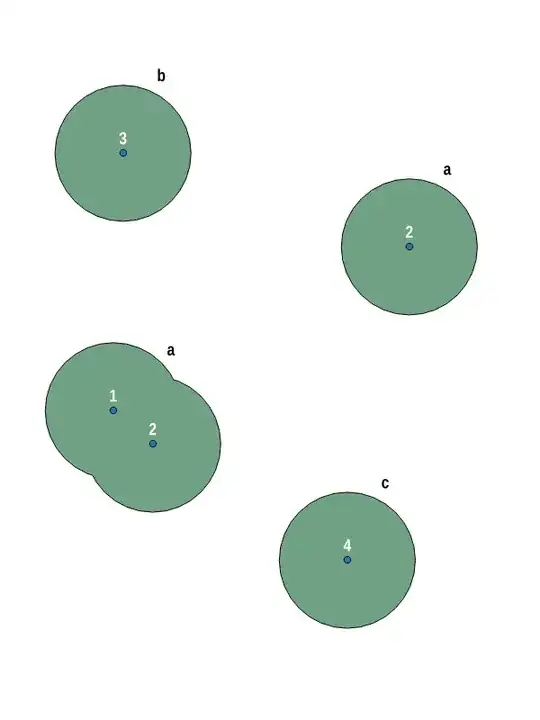

I've to create dissolved buffers from multi-point input features. In the example below, the input table contains 4 features. Feature #2 consists of two point geometries. After creating a buffer, I get 4 polygon geometries:
Is there a way to group the result? The buffers of the points #1 and #2 are dissolved and should be a single multi-polygon feature (a).

  • So you need to do a spatial union and then also a union based on feature number, which is why you expect 3 multipolygons from the diagram above. I suspect this will require a two-step process, but just wanted to be clear on the question, before offering an answer. – John Powell Mar 26 '17 at 20:58
  • Yes, I want to union the buffer polygons and collect the result based on the number of the input features. – eclipsed_by_the_moon Mar 26 '17 at 21:51

Starting with some random points, in an attept to imitate those in the OP's image, where the first two spatially intersect, then the 2nd and 3rd have the same attribute id (2), with a couple of other points that neither spatially intersect nor have the same attribute, the following query produces 3 clusters:

Using the WKT tool in QGIS, (and discovering how awful I am with the editing tools) produces clusters like the following, where you can see the cluster your- labelled as a, is all together -- ie, one colour.
