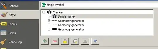

Styling
We will render the points with a Single symbol and by recurring to one Simple Marker and three Geometry generator symbol layers:
In the further explanation, I will follow the same order of the symbols in the image above.
1) Simple Marker
I chose a default symbol of a black star (this is the easier part of this tutorial), having a size of 3 mm and a width of 0.4 mm.
2) Geometry Generator No. 1
Add a new symbol layer and select the Geometry generator type:
Insert this expression in the Expression field:
CASE
WHEN abs( "ALKUKULMA" - "LOPPUKULMA") < 360
THEN
make_line(
 $geometry,
 make_point(
  $x + 1000*cos(radians(90 - "ALKUKULMA")),
  $y + 1000*sin(radians(90 - "ALKUKULMA"))
END
We have just defined the first line which points towards the point where the light sector starts from. This line is 1000 m long and it's created only when the opening angle of the sector light is not a round angle (this happens for avoiding that the line would break a whole circle).
3) Geometry Generator No. 2
Same as above but, in this step, you need to use this expression:
CASE
THEN
make_line(
 $geometry,
 make_point(
  $x + 1000*cos(radians(90 - "LOPPUKULMA")),
  $y + 1000*sin(radians(90 - "LOPPUKULMA"))
END
We have just defined the first line which points towards the point where the light sector ends at. This line is 1000 m long and it's created only when the opening angle of the sector light is not a round angle (this happens for avoiding that the line would break a whole circle).
4) Geometry Generator No. 3
CASE
WHEN abs("ALKUKULMA" - "LOPPUKULMA") <= 180 AND "ALKUKULMA" >= "LOPPUKULMA" THEN difference( boundary( buffer( $geometry, 900) ), make_polygon( geom_from_wkt( geom_to_wkt( make_line( $geometry, make_point($x + 2000cos(radians(90 - "ALKUKULMA" )), $y + 2000sin(radians((90 - "ALKUKULMA" )))), make_point($x + 2000cos(radians(90 - ("LOPPUKULMA" + "ALKUKULMA")/2 )), $y + 2000sin(radians((90 - ("LOPPUKULMA" + "ALKUKULMA")/2 )))), make_point($x + 2000cos(radians(90 - "LOPPUKULMA")), $y + 2000sin(radians((90 - "LOPPUKULMA")))), $geometry) )
WHEN abs("ALKUKULMA" - "LOPPUKULMA") <= 180 AND "ALKUKULMA" <= "LOPPUKULMA" THEN intersection( boundary( buffer( $geometry, 900) ), make_polygon( geom_from_wkt( geom_to_wkt( make_line( $geometry, make_point($x + 2000cos(radians(90 - "ALKUKULMA" )), $y + 2000sin(radians((90 - "ALKUKULMA" )))), make_point($x + 2000cos(radians(90 - ("LOPPUKULMA" + "ALKUKULMA")/2 )), $y + 2000sin(radians((90 - ("LOPPUKULMA" + "ALKUKULMA")/2 )))), make_point($x + 2000cos(radians(90 - "LOPPUKULMA")), $y + 2000sin(radians((90 - "LOPPUKULMA")))), $geometry) )
WHEN abs("ALKUKULMA" - "LOPPUKULMA") > 180 AND "ALKUKULMA" >= "LOPPUKULMA" THEN intersection( boundary( buffer( $geometry, 900) ), make_polygon( geom_from_wkt( geom_to_wkt( make_line( $geometry, make_point($x + 2000cos(radians(90 - "ALKUKULMA" )), $y + 2000sin(radians((90 - "ALKUKULMA" )))), make_point($x - 2000cos(radians(90 - ("LOPPUKULMA" + "ALKUKULMA")/2 )), $y - 2000sin(radians((90 - ("LOPPUKULMA" + "ALKUKULMA")/2 )))), make_point($x + 2000cos(radians(90 - "LOPPUKULMA")), $y + 2000sin(radians((90 - "LOPPUKULMA")))), $geometry) )
WHEN abs("ALKUKULMA" - "LOPPUKULMA") > 180 AND "ALKUKULMA" <= "LOPPUKULMA" THEN difference( boundary( buffer( $geometry, 900) ), make_polygon( geom_from_wkt( geom_to_wkt( make_line( $geometry, make_point($x + 2000cos(radians(90 - "ALKUKULMA" )), $y + 2000sin(radians((90 - "ALKUKULMA" )))), make_point($x - 2000cos(radians(90 - ("LOPPUKULMA" + "ALKUKULMA")/2 )), $y - 2000sin(radians((90 - ("LOPPUKULMA" + "ALKUKULMA")/2 )))), make_point($x + 2000cos(radians(90 - "LOPPUKULMA")), $y + 2000sin(radians((90 - "LOPPUKULMA")))), $geometry) )
END
We have just defined the arc between the starting and ending points of the light sector (please note that 2000 is an arbitrary value because I'm trying to create a polygon to intersect with the boundary of the circle having a radius of 900 m).
Furthermore, we need to set the color which is stored in the "VARIS" field. For doing this, we need to specify it with a custom expression. Follow the arrow in the image below:
and then type this expression after having clicked on the Edit... button:
CASE
WHEN  "VARIS" = 'vi' THEN color_rgb(51,160,44)
WHEN "VARIS" = 'v' THEN color_rgb(255,255,255)
WHEN "VARIS" = 'p' THEN color_rgb(227,26,28)
END
Please note that, for this symbol layer, I created two lines: the upper line defines the color to use (in fact I set the custom expression for this one), while the lower one is useful for defining a black border (it will have a width which is bigger than the one of the upper line). Remember also to set Flat as Cap style for both lines for avoiding any color overlapping.

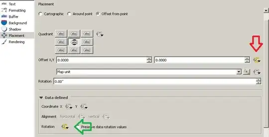

2) Setting the placement for labels
Select the Placement option in the Labels Menu and select Offset from point.
Then, with reference to the image below:
follow the red arrow and type this expression:
CASE
WHEN "ALKUKULMA" > "LOPPUKULMA"
THEN
concat(
 -1000*cos(radians(90 - ("ALKUKULMA" + "LOPPUKULMA")/2)),
  1000*sin(radians(90 - ("ALKUKULMA" + "LOPPUKULMA")/2))
WHEN "ALKUKULMA" <= "LOPPUKULMA"
THEN
concat(
  -1000*sin(radians(90 - ("ALKUKULMA" + "LOPPUKULMA")/2))
END
Then, follow the green arrow and type this expression:
CASE
WHEN "ALKUKULMA" >= "LOPPUKULMA"
THEN
180-(("ALKUKULMA" + "LOPPUKULMA")/2)
WHEN "ALKUKULMA" < "LOPPUKULMA"
THEN
- (("ALKUKULMA" + "LOPPUKULMA")/2)
END
