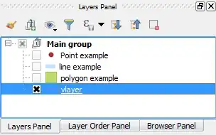

Related to the following question but looking for a PyQGIS method:
QGIS Layer Order Panel - add layers at top of layer order
The following is a simple setup containing a group with three layers.
Simple setup
The code I use adds a new layer at the end of this group:
root = QgsProject.instance().layerTreeRoot()
group = root.findGroup('Main group')
vlayer = QgsVectorLayer('LineString?crs=epsg:27700', 'vlayer', 'memory')
QgsMapLayerRegistry.instance().addMapLayer(vlayer, False)
group.insertChildNode(-1, QgsLayerTreeLayer(vlayer))
New layer added at end of group
In the Layer Order Panel, the newly added layer is at the end.
Layer Order Panel
Is it possible to move this to the top without moving the layer in the Layers Panel?

You can set layer order in the Layer Order Panel "manually" using QgsLayerTreeCanvasBridge.setCustomLayerOrder() method, which receives an ordered list of layer ids. For instance (assuming you just loaded vlayer):
bridge = iface.layerTreeCanvasBridge()
order = bridge.customLayerOrder()
order.insert( 0, order.pop( order.index( vlayer.id() ) ) ) # vlayer to the top
bridge.setCustomLayerOrder( order )
