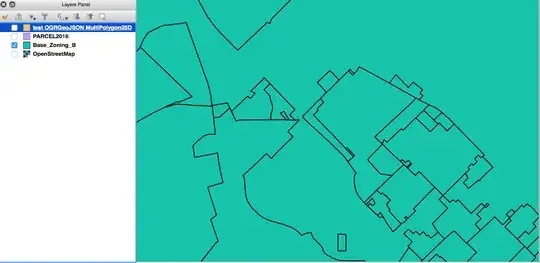

I have two shapefiles - Parcels2016 and Base_Zoning_B
Parcels2016 has about 660,000 records with over one hundred attributes (about ~2GB) , so performing spatial joins in QGIS is very inefficient, which is why I am trying to use PostGIS. I would like to find out what is wrong with the SQL command that I used to join attributes by location. If we look at the images below, the Base_Zoning_B layer is in green:

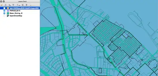

My goal is to join the attributes of Base_Zoning_B to the individual land parcels in Parcel2016 (in blue) and keep both matching and non-matching records:
Both commands I have used in PostGIS failed to produce the correct results as not all of the polygons were joined and it seems only matching records were kept, and not all of them either:
As you can see, in the testlayer, which I exported from PostGIS as a shapefile, there are many parcels excluded. I have executed both of these commands in PostGIS, one with a left join, one without, but both produce the same incomplete results:

    I suspect it is because you are excludiing invalid geometries. Perhaps try running ST_MakeValid on your geometries first and then re-run . – John Powell Dec 05 '16 at 07:53
  • What would be the command for that and can it be included in the code above? Would I have to Update the table first? – iskandarblue Dec 05 '16 at 08:30
  • UPDATE parcel2016 SET geom = ST_MakeValid(geom) WHERE ST_IsValid(geom) = 'f'' and repreat for the other table. You could include ST_MakeValid directly in the query, but I always think it is better to clean geometries separately in an update, so you know what you are dealing with. – John Powell Dec 05 '16 at 08:36
  • thanks. I am returned: `ERROR: Column has M dimension but geometry does not NOTICE: Ring Self-intersection at or near point 2500677.5199999958 6921843.0100000054 0
    Query returned successfully in 2 min.`
    – iskandarblue Dec 05 '16 at 08:52
  • See this question about that error. If you now only have one invalid geometry, you might retry your original query to see if you get complete results now? – John Powell Dec 05 '16 at 08:59
