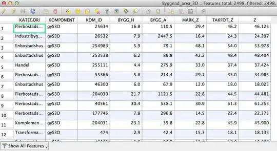

I have a vector layer with 2498 features (houses) that I want to rasterize/produce a raster image from but can't figure out how:
Column MARK_Z = is Meters above see-level for the base of each house
Column Z = Total meters above see-level for each house
Column BYGG_H = is each buildings total height from base
So ideally I would want code two of them into the new raster attribute, but Raster > Conversion > Rasterize (Vector to Raster) only let's me chose one, so I'm looking at different ways to solve this.
I have a PostGIS up and running with Qgis, How can I rasterize this with PostGIS through Qgis?

enter image description here enter image description here enter image description here

I've seen a lot of the same problems you have with this dataset (both this question and your others), and struggled to get this into postgres.
Importing into postgres
Your geometries are of type 31 - shp2pgsql doesn't like that (it's expecting 1006). So create a new shapefile from the old with ogr2ogr, and tell it to save as MULTIPOLYGONZ
ogr2ogr -f "ESRI Shapefile" fixed.shp ./Byggnad_area_3D.shp -nlt MULTIPOLYGONZ
That gets us to the next problem :)
You may need to change the postgres database encoding. I tried several (UTF-8, LATIN1, LATIN4) without success... I get encoding errors. Used this to set the database encoding (I called mine 'sweden')
update pg_database set encoding = pg_char_to_encoding('LATIN1') where datname = 'sweden'
Limitations of gdal_rasterize
A further problem is that gdal_rasterize doesn't support burn values for polygon z coordinates (source). There's a -3d option but according to the docs...
Indicates that a burn value should be extracted from the "Z" values of the feature. As of now, only points and lines are drawn in 3D.
I was able to convert the fixed.shp to lines, and rasterize that. But I suspect that's not quite the effect you were after.
