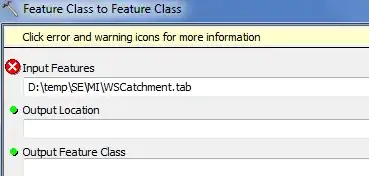

I'm not very familiar with TAB files, but when I view them in ArcCatalog they appear to be similar to a geodatabase which holds different feature classes with different geometries. When you reference a feature class in a geodatabase you construct a path like c:\mydata\mygeodatabase.gdb\myfeatureclass where you specify the feature class name after the geodatabase name.
It appears that you need to do something similar with the TABfile. My file looked like c:\mydata\mytabfile.tab\mytabfile point where you've got the name and geometry type after the tab filename.
When I try to run Feature Class to Feature Class on just the TAB file I get an error (same as yours from arcpy)
But when I include the actual geometry from inside the file, the tool accepts it and outputs it as expected
You may need to modify your script to something like this:
for root, dirs, files in os.walk(path,topdown=False):
   for file in files:
      if file.endswith(".TAB"):
         fc = os.path.splitext(file)[0]
         fcnamegeom = "{} point".format(fc)
         tabFile = os.path.join(root, file, fcnamegeom)
         print(tabFile)
         outLocation = "C:/temp3/results.gdb"
         outFeatureClass = fc
         arcpy.FeatureClassToFeatureClass_conversio(tabFile, outLocation, outFeatureClass)
This takes the name of the TAB file and removes the extension, and uses that as the feature class name and combines geometry type point to it (could be changed to whatever geometry type you're using). It then outputs the feature class to your geodatabase results.gdb using the feature class name as the output name.
There doesn't appear to be a way to get arcpy to automatically read the contents of the TAB file (using something like arcpy.ListFeatureClasses() or similar), so you may need to know what each one is beforehand - perhaps storing them in a gdb table and reading that to get the names and geometry type to pass through to your arcpy.FeatureClassToFeatureClass_conversion() tool.
