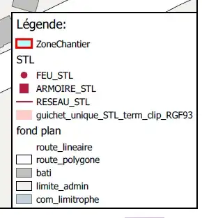

But the layer set is not the one I want.
I found this post: Filter MapComposer legend to only show layers visible on the map
I adapted its code to mine and I have this:
With the code:
    legend = QgsComposerLegend(c)
    legend.setTitle(u"Légende:")
    layerGroup = QgsLayerTreeGroup()
    for layer in layers:
        layerGroup.insertLayer(0, layer)
    legend.modelV2().setRootGroup(layerGroup)
    c.addComposerLegend(legend)
The issue is that I would keep the initial tree organization, and just suppress the layers I don't want.

OK I managed to solve the problem...
To set my layerTree in the legend, I tried to modify directly the layerTreeRoot of the project (I work with a copy of the original project, the layers are never deleted...)
I have built a recursive function to check if each layer in the tree is in my list, and if not, I remove it.
The main code now looks like this:
    root = buildLegendLayerTree(project.layerTreeRoot(), layers)
    legend.modelV2().setRootGroup(root)
With the following definition for the function:
    def buildLegendLayerTree(root, layers):
        for child in root.children():
            if child.nodeType()==0: # if the child is a group node, not a layer
                child = buildLegendLayerTree(child, layers)
            else: # if it is a layer
                if child.layer() not in layers:
                    root.removeChildNode(child)
        return(root)
And now I have the result I expected :)
