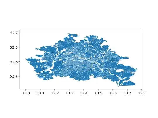

Dowloading the shape file repository of Berlin, here are some of the solutions.
joris
This solution only takes 20s to execute.
import geopandas
import matplotlib.pyplot as plt
df = geopandas.read_file('berlin-latest-free.shp/gis_osm_landuse_a_free_1.dbf')
df.plot()
plt.savefig('test2.png')
It looks a bit as if the projection was not done at all or not done correctly.
