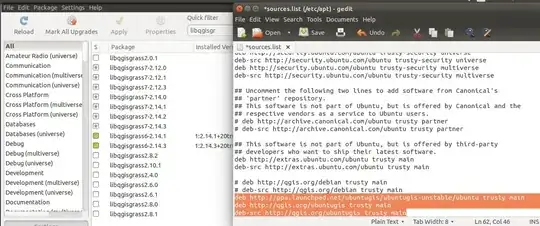

I started with these repositories: # deb http://qgis.org/debian trusty main and # deb-src http://qgis.org/debian trusty main.
First comment those two out (or the ones you have).
And then add those highlighted in the picture... you can find those in the QGIS installation pages.
Then update the list using for example Synaptic or via the terminal. You can see in the left side of the picture that I have already updated the list but still have the libqgisgrass6-xx packages active and the libqgisgrass7-2.14.3 waiting for installation.
starting repositories and fixed ones
After installing the libraries referencing GRASS 6 and installing the one for version 7 you would probably there... here is the situation now (but see below for an additional possible complication)
