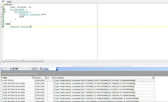

I have a table of Multiline Strings and need to generate a GeoJSON with the properties turning to EPSG 4326. I made the SQL below but is not in the correct format GeoJSON.
How do I create the GeoJSON using Postgis, so I have a FeatureCollection with the CRS 4326 set.

  • please add an example of the rows in the table and the output that you get, preferably with an explanation of why it is not correctly formatted – Ian Turton Jun 10 '16 at 12:41
  • it is not so simple, have a look at http://www.postgresonline.com/journal/archives/267-Creating-GeoJSON-Feature-Collections-with-JSON-and-PostGIS-functions.html. – user30184 Jun 10 '16 at 12:47
  • Edited to show the current point where I am – csf Jun 10 '16 at 12:48
  • Tks @user30184! I'm exercising the example provided on the site and actually seems pretty simple! But the error occurs type "json" does not exist I use PostGIS 2.0.6, preicso enable something ?: – csf Jun 10 '16 at 12:59
  • I apologize, I have never done that myself. However, the json part with test query works for me select row_to_json(foo) from (select name from test_table limit 1) as foo; – user30184 Jun 10 '16 at 13:14
  • I have done it. It gets complicted, as going from rows to JSON collections isn't that obvious, but see this answer, http://gis.stackexchange.com/questions/124413/how-to-export-thousands-of-features-from-postgis-to-a-single-geojson-file/124415#124415, in which I cite the original postgresonline article. – John Powell Jun 10 '16 at 13:16
  • Thanks for the link! As for the error I need to update my Postgres SQL that is at version 9.1 – csf Jun 10 '16 at 13:17
  • Your geometries are already in 4326. – John Powell Jun 10 '16 at 13:17
  • But you might need to add the crs into the GeoJSON, as in this example: http://help.cadcorp.com/en/7.0/sis/help/Savers_GeoJSONFeaturesDataset.html – John Powell Jun 10 '16 at 13:20
