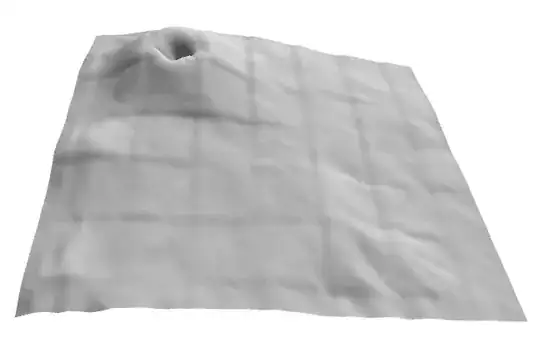

I am reprojecting a SRTM 3 arc-second raster file from WGS84 geographic coordinate system, to projected coordinate system which is using Azimuthal Equidistant projection:
gdalwarp -s_srs EPSG:4326 -t_srs "+proj=merc +lat_ts=40.81266 +lon_0=14.414252" -r near -of GTiff C:/vesuvius2_wgs84.tif C:/vesuvius2_aeqd.tif
I attached the initial raster file in here (vesuvius_wgs84.tif).
The issue is that if I use the Nearest neighbor resampling method (-r near), some sort of "stripes" appear on terrain once I reproject the file to Azimuthal Equidistant projection. Here is the how the reprojected raster looks like:
vesuvius2_aeqd.tif
And here is its 3d representation:
vesuvius2_aeqd.tif 3D
Interestingly similar "stripes" appear in both direction if I reproject the initial raster to UTM:
gdalwarp -s_srs EPSG:4326 -t_srs EPSG:32633 -r near -of GTiff C:/vesuvius2_wgs84.tif C:/vesuvius2_epsg32633.tif
The "stripes" go away when I use Bilinear or Cubic resampling methods (-r bilinear, -r cubic) instead of the Nearest Neighbor one.
Why do these "stripes" appear when Nearest Neighbor resampling method is used?

    try -r I think the 'near' is causing the stripes. Good choices are bilinear, cubic, cubicspline. These methods will take longer to create an output but I think it will be more usable. The boxes come from deep in the code. It's not as important to know where they come from only that they do appear when using this resample method. Near is supposed to be used for succinct data like land classes and not continuous like DEM data. – Michael Stimson Apr 25 '16 at 21:50
  • I have the feeling your source data were made by overlapping tiles. And you added the overlapping areas in the process. – nickves Apr 25 '16 at 21:57
  • Thank you for the replies, both @MichaelMiles-Stimson and nickves.
    • yes, the "stripes" disappear when bilinear or cubic are used. Can you just explain a little bit more what "succinct data like land classes" are?
    • nickves: No overlapping tiles, I downloaded a clean raster area from opentopography.org
    – marco Apr 25 '16 at 22:05
  • Succinct data is classified data, like a raster where 1='water', 2='urban' etc.. for each cell, the data is integer and only contains a collection of a few values, conversely continuous data is of a float (or int, but rarely) type and each cell potentially has a different value to all other cells. The nearest operator tries to assign the value of the closest warped cell expecting unique values which shows up as steps or boxes in continuous data. – Michael Stimson Apr 25 '16 at 22:09
  • @MichaelMiles-Stimson thank you. How can I mark your reply as the problem solving one? – marco Apr 25 '16 at 22:13
  • I would suggest you take the comments and expand them into an answer. Comments are not answers and can't be marked such. Compile them, answer your own question (yes you can do this) and this will show future users having the same problem how to fix it. – Michael Stimson Apr 25 '16 at 22:15
  • @MichaelMiles-Stimson, I am not sure I understand you. Can't you post a separate answer down below by copying your comment? – marco Apr 25 '16 at 22:20
  • Sure, I've got some time. – Michael Stimson Apr 25 '16 at 22:37
