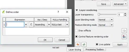

Just tried to do something like this in Qgis 3.44, as expected the design has changed.
Select Layer, Properties, ->Symbology
On this dialog on the left hand side lurking about the Help and Style button there is 'Layer Rendering', expand it.
Towards the bottom on the screen there is a clickbox 'Control feature rendering order' enable it. Look in the far right side, there is a button labeled AZ with a down arrow, click it, then creates a popup called Define order, you can then use a variable or an expression to control the rendering
See attached image Qgis with modules pop up
