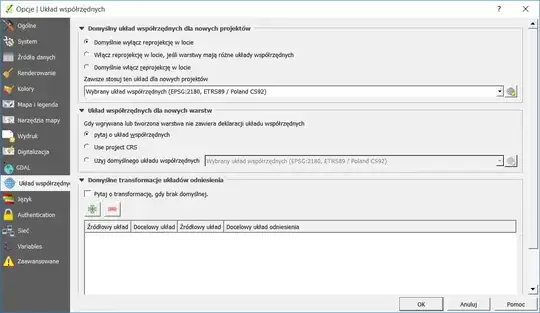

Regarding project properties, I set enable on the fly CRS transformation and chose ETRS89 / Poland CS92 as my project CRS. For Settings->Options->CRS I chose Automatically enable on the fly reprojection by default; and use project CRS for new layers.
