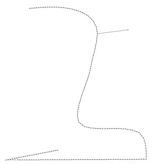

I need to find an algorithm or method that can detect outlier latitude longitude points in a trajectory during post-processing, which can then be fixed (brought back into the trajectory's path based on its neighbours).
As an example of the kind of outlier points I would like to detect and fix, I've attached an image demonstrating:

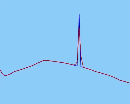

I have tried using an unscented Kalman filter to smooth out the data as best as possible, but this does not seem to work effectively enough for more extreme outliers (raw data in blue, smoothed data in red):
My UKF may not be calibrated properly (but I'm fairly certain that it is).
