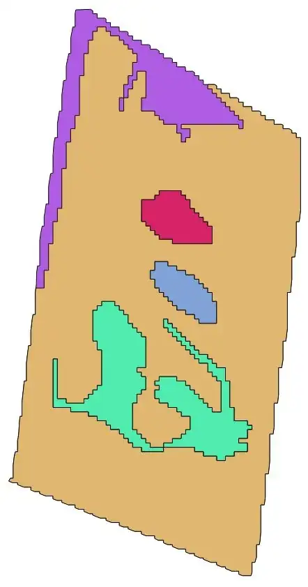

I am aware of Finding centrelines from polygons in QGIS? but I am looking for another Open Source GIS way to do this.
Is there a possibility to create centerlines in PostGIS?
I have this shapefile (see below) which contains different zones. I need a centerline in each zone - it may not be one line, it can be more (for example in brown zone).
In ArcGIS I can separate each zone as a new shapefile and then use ET Geowizard to create that lines.
Zones

  • Thanks guys, ST_ApproximateMedialAxis seems to be the solution of my problem. – Tomáš Kudela Nov 19 '15 at 12:14
PostGIS has ST_StraightSkeleton, which implements a polygon thinning algorithm:
ST_StraightSkeleton — Compute a straight skeleton from a geometry

    Or ST_ApproximateMedialAxis that its doc links to. Seems to create less noisy results. – lynxlynxlynx Nov 13 '15 at 17:52
    Note that you need to build PostGIS from sourfce with SFCGAL support to use these functions. You can mirror the behavior with Voronoi polygons. Some read about that available at https://www.safaribooksonline.com/library/view/postgis-cookbook/9781849518666/ch06s06.html – Michal Zimmermann Nov 15 '15 at 07:39
