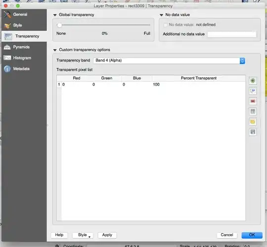

voilà: same result as adding them by hand in the layer properties:
