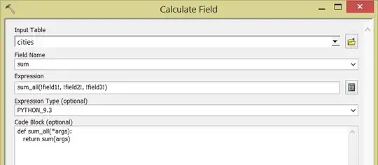

First create a field on your table to summarize the values in. Then take a look at Calculate Field.
In the below, update the Expression parameter to include all the field names you want to sum per row.
DWynne
  • 2,394
    I'm wondering if this expression (and using sum_all) would pay attention to whether fields are on or not. If so, you could use the layer properties Fields tab to do some quick on/off manipulation and then run this. Otherwise I'm guessing you'd need a formula or something to get only the desired fields (similar to Felix's answer), and they'd have to have something all unique and in common (ie, all have "score", and not need just 6 of 10 "score"s). Else you're back to manually picking field names from a long list. – Chris W Jun 11 '15 at 01:24
  • Anything manual is not going to work if BabbA is serious about that number of fields. Switching unwanted fields off (I use it all the time working with 'wide' tables) might help slightly with @ChrisW solution, but it is a nightmare to pick more than 10 required fields. The only feasible are mine and radoxju. My requires less skills (no need in custom toolbox, adding script, etc), radoxju's is much faster, credits to him – FelixIP Jun 11 '15 at 03:57
  • @FelixIP. Right, but he has only loosely defined what fields he wants to summarize. – DWynne Jun 11 '15 at 05:06
