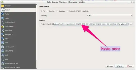

As an alternative to using a plugin, you can give the Add Layer command a semicolon-delimited list of files. You can create such a list in the following manner:
cd /d <Path_to_the_directory_where_your_files_are>
dir *.shp /s /b >All.txt
This gives you a file named All.txt, which contains the paths to all the files with a specific extension (you can use a different mask depending on the files you have), where each file is on a new line.
D:\Data\01\data01_1.shp
D:\Data\01\data01_2.shp
D:\Data\02\data02_1.shp
D:\Data\02\data02_2.shp
Then simply replace all newlines with ; using a text editor (like Notepad++) and paste the result in the Add Vector Layer... dialog.
For Notepad++ you need to change the replace mode to Extended and replace \r\n with ;. You would get a file that looks like this:
D:\Data\01\data01_1.shp;D:\Data\01\data01_2.shp;D:\Data\02\data02_1.shp;D:\Data\02\data02_2.shp
UPDATE: Newer versions of QGIS expect a list of files where each entry is enclosed in double quotes and the entries are separated by a single space instead of a semicolon. So once you have the list of files from the first step, do the following replaces in Regular Expression mode:
Find what Replace with
^(?<file>(.+))$ "\1"
\r\n (space)
If you don't have a regex-capable editor handy, you can replace the start of your path with a double quote and the path (say, D:\Data\ with "D:\Data\) and the extension with the extension and a double quote (say, .shp with .shp").

On Linux, you can extract a list of .shp files and feed it directly into the "Import Vector" dialog:
#on the command line
ls /home/yourpath/*/*shp|tr "\n" '@'|sed 's/@/" "/g'|sed 's/^/"/g'
I found this useful under QGIS Docker, beacuse for some reason the "Load Them All" plugin was not showing its dialog.
