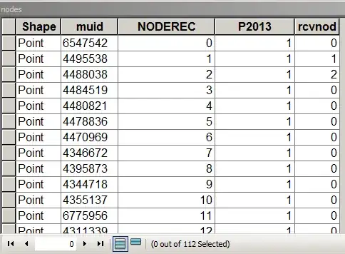

Calculate catchment centroids (UniqID=PAR_ID). They are nodes or network. Connect them by lines using spatial join table. This is separate topic surely covered somewhere on this forum.
The script below assumes that nodes table looks like that: enter image description here
where MUID came from parcels, P2013 is field to summarise. In this case = 1 for counting only. [rcvnode] - script output to store group ID equal NODEREC of the first node in the group/cluster defined.
Links table structure with important fields highlighted
Times stores link/edge weight, i.e. cost of travel from node to node. Equal 1 in this case so that cost of travel to all the neighbours is the same. [fi] and [ti] are sequential number of connected nodes. To populate this table search this forum on how to assign from and to nodes to link.

  • In reality nodes and links layers are just visual things. Cleaned-up table of spatial join can easily replace link table, because from and to nodes are already assigned. Polygons table, can easily serve as nodes table, just add ReceivingNode field and transfer sequential numbers from it back to 'links' [FromI] and [ToI]. – FelixIP Jan 30 '15 at 02:35
