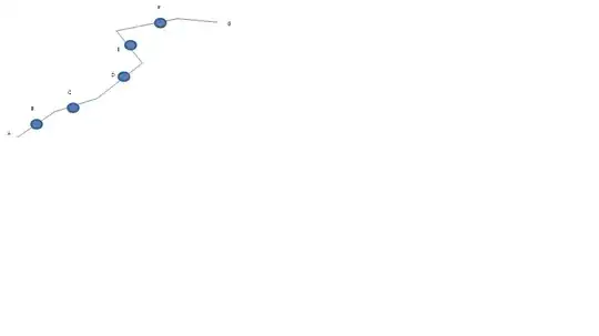

Example 1: line with points lying along
This is not an answer, but an attempt to explain the question better, following Chris' comment.
@Chris, the links you gave are nice but quite different from what I want to achieve. I am not trying to get the individual segments of lines based on the vertices of the lines themselves. What I am trying to achieve is to make sublines from lines based on where points from a different table intersect the lines. I think my diagram is a bit confusing, I have uploaded something better.

  • The second image does better explain your goal. As John mentioned, you should use the edit button at the lower left of the question to provide additional information or revisions rather than posting as an answer. ArcGIS has a tool for this called Split Line at Points, but I'm afraid I'm not familiar enough with PostGIS to offer a solution. Maybe this one: http://gis.stackexchange.com/questions/112282/ – Chris W Dec 02 '14 at 18:35

  • Thanks a million guys, I have solved this problem using your wonderful suggestions. The link Chris gave actually related to the exact problem I was trying to solve. I must apologize that I had to rephrase my question using the "Add Answer" button because I needed to add an image which I could not do through the "Add comment" button. Once again thanks, I really appreciate! – qgisgirl Dec 03 '14 at 23:40
